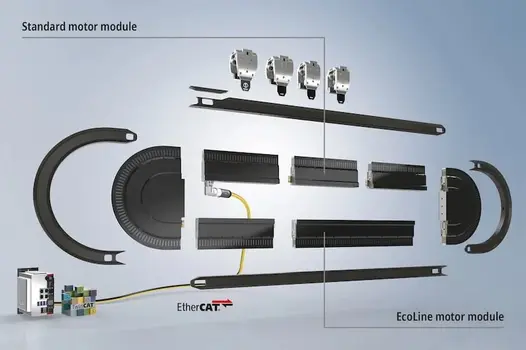

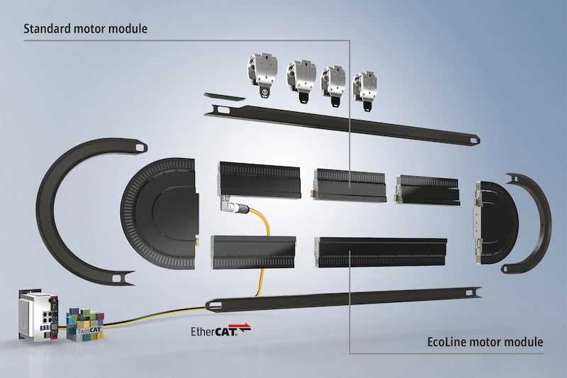

    Beckhoff, EcoLine modülünün yüksek hassasiyetli XTS modülleriyle birlikte kullanılabileceğini vurguladı. Bu sayede, üreticiler daha özel taşıma yolları oluşturabilir ve sistemlerini optimize edebilir.
    e new motor module handles standard transport paths, while high-precision modules handle process stations requiring stricter tolerances. This combined hybrid approach lowers the system's overall cost without affecting the production quality. Industries such as battery manufacturing, packaging, assembly, lab automation, and pharmaceuticals are potential areas where the new motor module can be adopted for flexibility and lowered operational cost.
    XTS EcoLine motor modules are fully compatible with standard motor modules.
    XTS EcoLine motor modules are fully compatible with standard motor modules. Image used courtesy of Beckhoff
