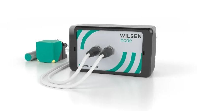

Now, in addition to wireless sensors, two volt-free contacts can be connected to Pepperl+Fuchs’ LoRaWAN wireless sensor node, enhancing long-range data transmission possibilities in existing control systems.
Pepperl+Fuchs has added the ability to connect volt-free contacts to the WILSEN.node wireless sensor node. The WILSEN.node is designed to add Industrial Internet of Things (IIoT) functionality to existing hardware systems, making it a way to retrofit equipment for modern data collection and process control. The newest upgrade to this hardware is the ability to connect isolated, volt-free contacts like switches and relays, which enhances system flexibility, reduces electrical noise, and increases electrical safety.
The WILSEN.node is Pepperl+Fuchs wireless sensor node that utilizes LoRaWAN technology

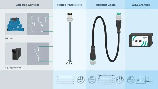

Volt-free contacts, such as relays and toggle switches, can be connected to the WILSEN.node with the use of an adapter cable

Volt-free contacts can be connected to the WILSEN.node via a resistor network and adaptor cable. This allows switches and relays to be up to 10 m away from the WILSEN.node. The cable can also be routed through the housing for a clean, compact installation.

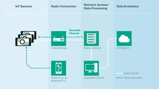

The WILSEN.node utilizes a LoRaWAN network to enable signal transmission over long distances, bringing IoT capabilities to existing systems
