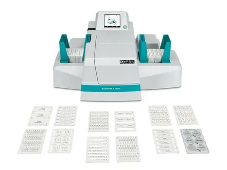

    Phoenix Contact’s new BLUEMARK E.CARD is a UV inkjet printer designed to speed up and simplify industrial labeling. The printer targets control cabinet builders and system manufacturers who face growing regulatory and operational demands for accurate component identification.
    Phoenix Contact’s BLUEMARK E.CARD is a UV inkjet printer designed to simplify industrial card printing

    Phoenix Contact’s new UV inkjet printer, the BLUEMARK E.CARD, aims to address these needs by automatically printing durable, high-resolution labels capable of withstanding harsh industrial environments. The printer’s UV LED-curing inks produce markings that are reportedly scratch-resistant, chemical-resistant, and long-lasting.
    BLUEMARK E.CARD UV Inkjet Printer

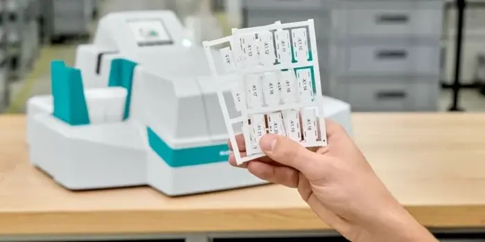

    Unlike manual card-processing printers, the BLUEMARK E.CARD uses an automated card transport system. Operators can load up to 40 marker cards, which feed automatically into the device. Additional cards can be inserted without stopping the job, and each card requires less than 53 seconds to print.
    Phoenix Contact highlights efficiency as a core benefit of its new printer, stating that the
    BLUEMARK E.CARD’s automated material processing saves users up to 40% of printing time compared to manual UV inkjet printers. This reduction in cycle time allows control cabinet and system manufacturers to accelerate project delivery while reducing operator workload.

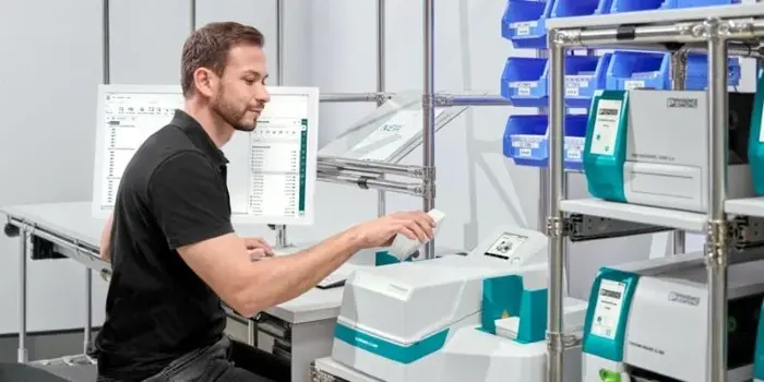

    The BLUEMARK E.CARD integrates with Phoenix Contact’s MARKING system software to simplify setup and organize projects. The software detects misordered cards and prints them correctly, eliminating errors and wasted materials.

    The BLUEMARK E.CARD integrates with Phoenix Contact’s MARKING system software, which aims to simplify setup and organize projects. The software detects misordered cards and prints them correctly, eliminating errors and wasted materials.
    Through a bidirectional OPC UA communication interface, the printer supports network-supported data exchange, aligning with current Industry 4.0 practices. A built-in display provides real-time device and job information, giving operators full visibility during large-scale print runs.
