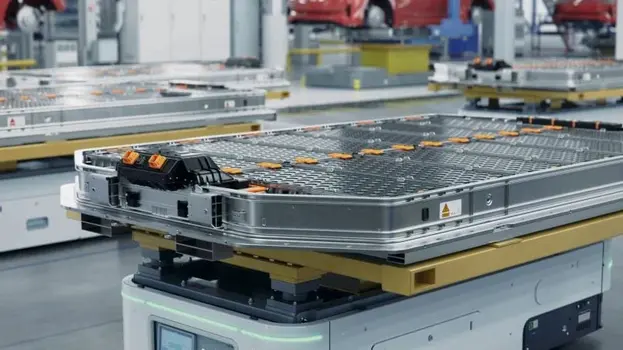

    With the use of machine learning models, Recirculate’s system maps out battery parts for robotic disassembly
    With the use of machine learning models, Recirculate’s system maps out battery parts for robotic disassembly. Image used courtesy of Adobe Stock
