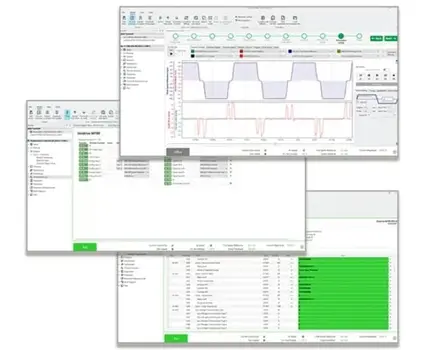

Connect V3 shows drive setup, tuning, and diagnostics in a single interface.
Connect V3 shows drive setup, tuning, and diagnostics in a single interface. Image used courtesy of Nidec
Connect V3 is Nidec’s updated PC software for setting up and maintaining servo drives like the Digitax HD series. The interface has been overhauled to make the software more intuitive, with step-by-step guides that help users through tasks such as motor selection, communication setup, and basic motion tests. The built-in diagnostic tools reduce the need to jump between different programs, helping teams catch issues earlier and keep systems running reliably.
Redesigned Interface and Setup Guidance
Connect V3 features a redesigned interface with guided steps for drive commissioning. Users can auto-discover drives over Ethernet, Serial, or Bluetooth without manual IP setup. EtherCAT systems are also supported, and TwinCAT users can bypass EoE configuration entirely.
Motor selection is handled through a dropdown list, and axis movement can be tested directly in the tool. Connect V3 also has built-in help prompts that can help reduce the need for reference manuals during setup, which gives integrators a straightforward format and minimizes unnecessary clicks, making it practical
for both experienced users and those less familiar with the system.
Real-Time Tuning and Motion Analysis
Connect V3 features an integrated scope that allows users to monitor their system's behavior in real time during tuning. All key parameters, such as gains, motion profiles, and I/O status, are readily available on one screen, which helps reduce time spent jumping between menus. Visual tuning with live plots and adjustable sliders makes it easier to see step response and refine control settings with minimal trial and error.
Connect V3 can provide real-time system tuning with a built-in scope and unified parameter view.
Connect V3 can provide real-time system tuning with a built-in scope and unified parameter view. Image used courtesy of Nidec
The logic diagram viewer provides a dynamic view of drive logic, including signal flow and I/O states, aiding in commissioning and troubleshooting. Drive parameter sets can also be backed up and restored quickly for use across multiple axes or machines.

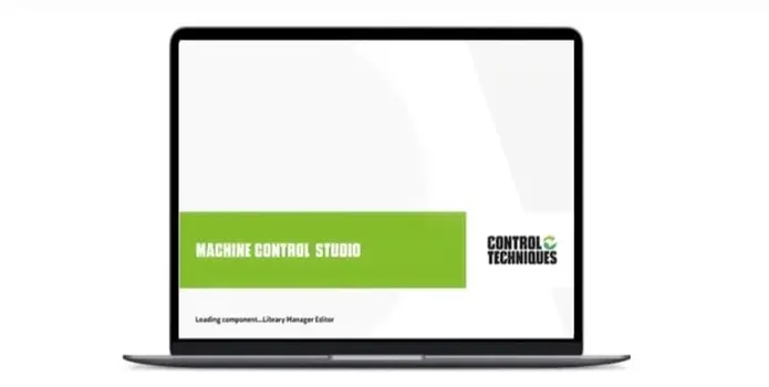

While Connect focuses on setup and tuning, more complex control logic can be programmed using Nidec’s Machine Control Studio. This IEC 61131-3 compliant environment supports Structured Text, Ladder Diagram, and other standard automation languages. It also enables programming for onboard PLCs and integrated MCi modules and allows for Ethernet network data configuration.
Machine Control Studio enables IEC 61131-3-compliant programming for Nidec drives.
Machine Control Studio enables IEC 61131-3-compliant programming for Nidec drives. Image used courtesy of Nidec
*Machine Control Studio enables IEC 61131-3-compliant programming for Nidec drives. Image used c
